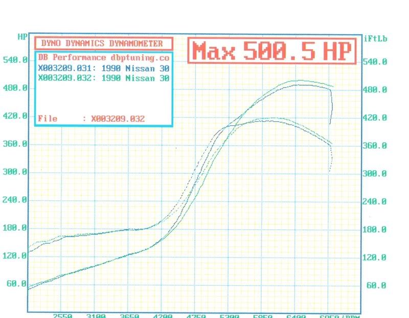

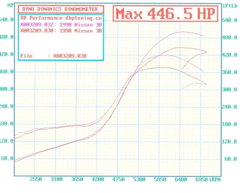

Message finally we were able to get some tuning in with my AEM EMS and my single turbo setup
this one is at 13.5psi peak hp with the cut out closed
15.5psi at peak hp with the cutout open
the setup does lag a fair amount but the car is just a hoot to drive on the street.
I have to send the EMS back into AEM (for the second time) to have them fix what ever makes it control the boost control silenoid.
comments?
